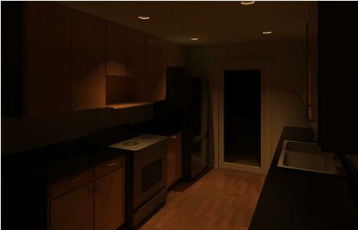

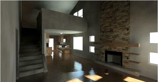

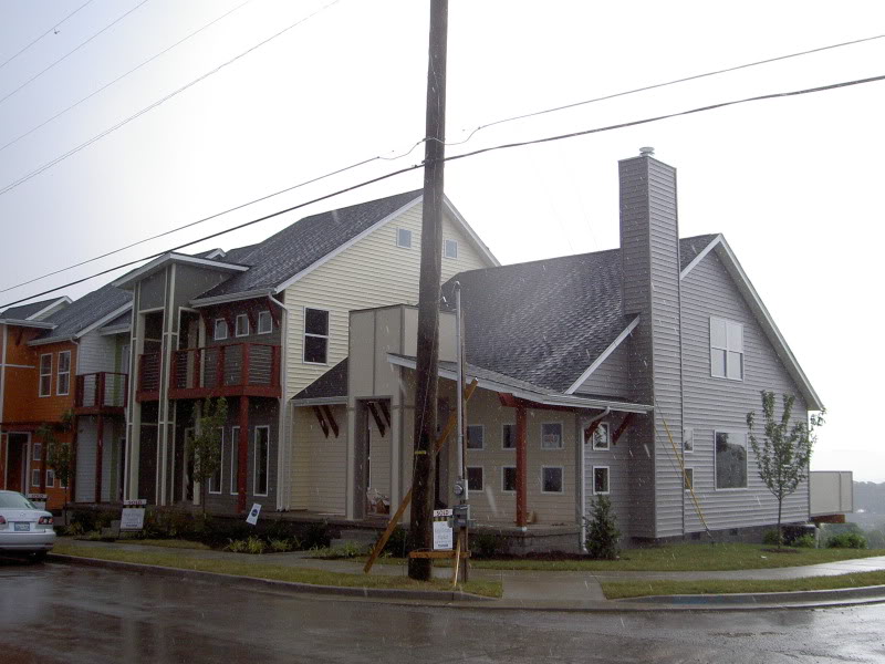

I've done the same with my home as well. You'll have your main project file and then you'll have family files (the template you use will vary depending upon the type of model you're trying to make ie: wall based, ceiling based, generic model, etc.) If you can't download content from this site you'll have to make it yourself...and I've made a bit myself and then inserting it into my project. Below are a few pictures of my house (the end unit of a townhome development). I've had to add in separately profiles running vertically around the front of the house. The kitchen cabinets were modified from the standard Revit cabinets to fit my home. I had to model the range, microwave, and fridge myself as Revit families. The same was done for the fireplace (a wall based family). You'll have to create your components in separate family files and then load them into your project...which is the easiest way to do it rather than modeling objects in the project itself which is only good for a select few things. Drawing this all in Revit taught me a ton about the program and making families. Edited on: Fri, Jan 29, 2010 at 1:30:29 PMEdited on: Fri, Jan 29, 2010 at 1:31:53 PM
