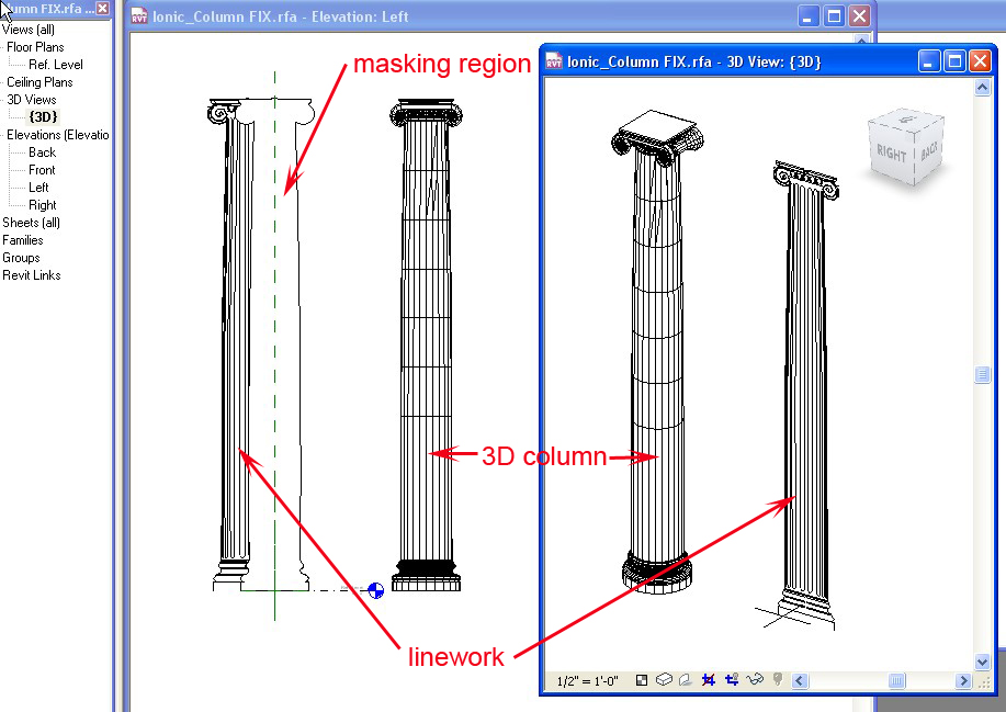

I have a complex 3D column in my model, which works great in 3D, but ius clunky in elevation drawings.
My solution was to edit the family and add line drawings with the correct detailing visivle only in elevation views using the visiblity settings.
This works great with one exception - the columns are see through. I drew in masking regions but since the linework for both the front/back and left/right views interseact at the centerline of the column, the lines get wiped out on one side and not the other.

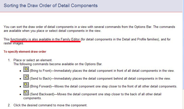

Should I move all the linework away from the center? Also, for some reason after reading the help menu, I can't seem to locate the display order function or the "Options" toolbar with the icons indicated.
Suggestions? Thanks!

You can set view specific visibility of individual model components in the family.  So if you want some model elements to show in elevation, keep those turned on but if you want to represent other portions with masking regions and detail lines, then turn off the model elements.
BTW, when using masking regions and symbollic lines in the same location, draw the masking region first then place the symbollic linework overtop the masking region.  Also note that the perimeter of the masking region can be your linework and no need to add lines there - just choose the right linework for the mask sketch.  These lines can be mixed including invisible perimeter lines.

Upon further research, and testing, I now see the options bar appear when I create a masking resion within my model, but I cannot see to get that functionality within my family, even though it's supposed to be there according to the help (see attachment).
Suggestions?

Thanks for responding. Yes, I did everything you mentioned including the visibility settings for each view.
The last image indicated the masking region on the left with the 3D column temporarily moved to the right. I did the linework forst however, and created the masking region second. So I need to move the linework to the front in the left view as well as the front on the right view with the masking region in between if that makes sense so it wipes out everything behind it from all sides.

Read what comes next after your underline.  I don't believe you are doing a detail or profile family.  Also note, I said to do your masking region first then the linework... This is a draw order.... can't just move them.  So... have two families side by side.  Erase these lines in the good family then copy paste onto your masking region.  That will get the correct draw order.

Are you trying to do this in 3D mode?  Symbollic lines are 2D so you do them in 2D.  I don't have any problems.  The attached "column" is turned off in elevation and represented by a masking region with "Z" lines overtop that in the elevation view of the family.

All the drawing happened in 2D views, which is proving difficult since I cannot tell what plane the masking region is on (maybe that doesn't matter).
In the attached image, you can see the masking region, the 3D column, and the 2D linework.
Of course, once I get the linework to work on the east/west face, I'll have to copy it and rotate it 90 degrees to represent the north/south views.
This worked great (you can see in the econd image), but they have no masking region behind them.
I used model lines in other families for more details, and they worked fine (see image).
Draw Order in Family Editor
