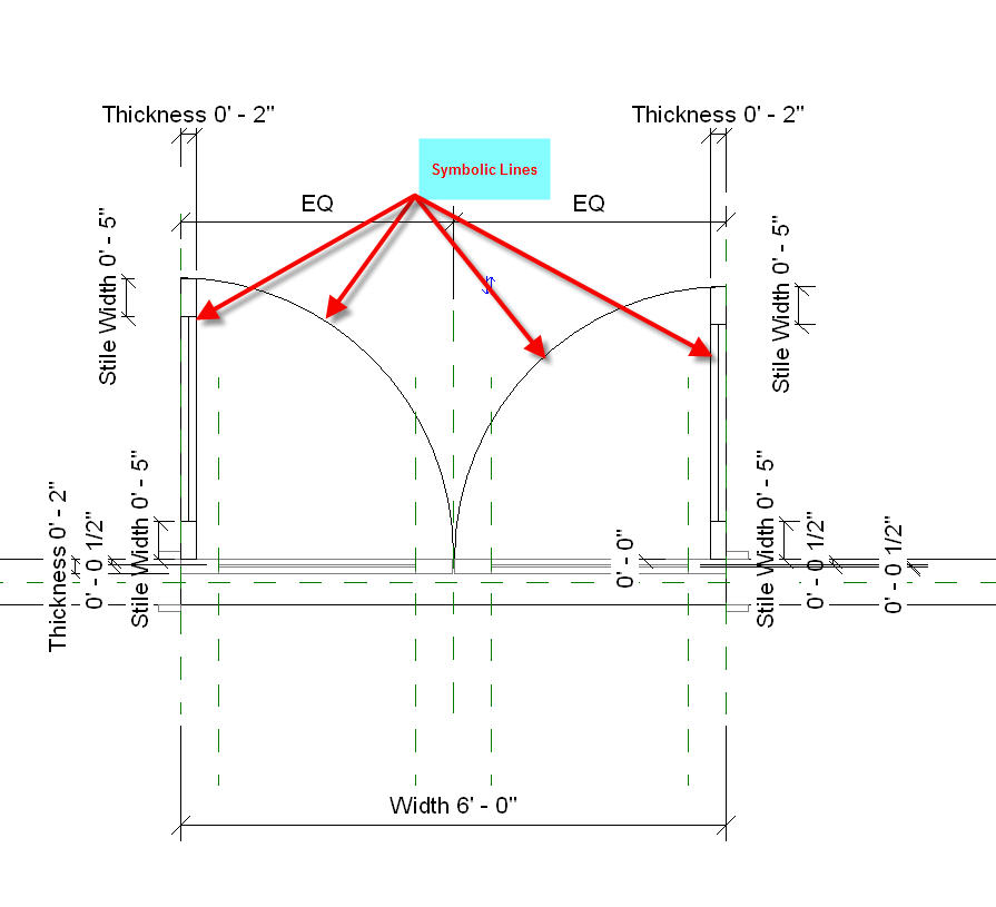

Does anyone know how you can modify a family of double doors (french doors in this case) to show one open in full swing, and the other one closed (permanently fixed). I know it has to be something simple, but I can't seem to figure it out. Any suggestions?

If you look at the family in plan it probably has the door panels drawn with symbolic lines. Just re-draw the symbolic lines so the one door is shown closed. Be carefull to set up correctly so it will flex if you change the size of the door. See Attached jpg
