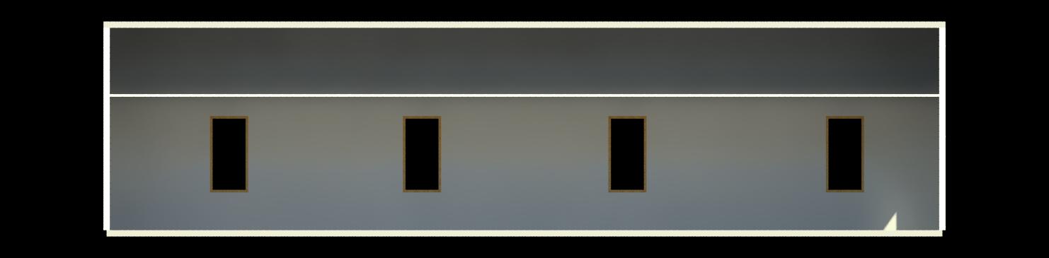

Hey Guys
I am having some problems when trying to encase/return my suspended ceiling.  I was wondering what is the best way round this.  I have attached a picture to illustrate the problem.  Thanks

Create the Ceiling in that room with the thickness you want at the height you want....

I'd create that with a model in-place - Ceiling family...

Cheers guys... works great.
