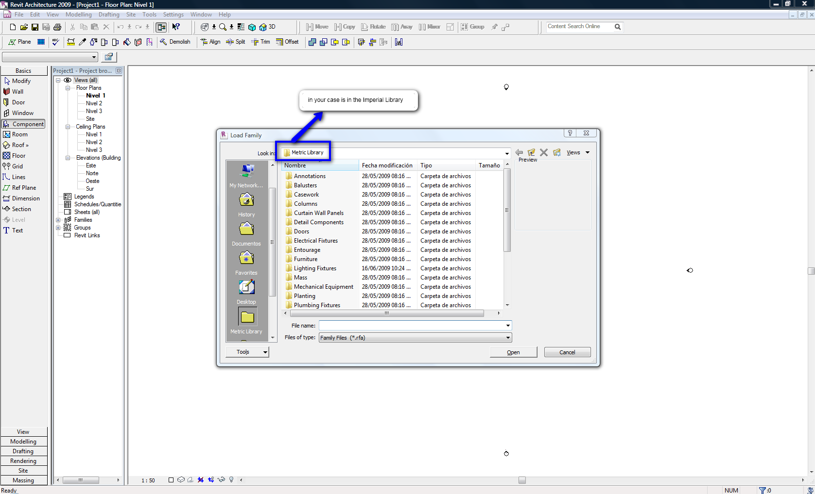

![erland73 Avatar](user_avatar/39932.jpg)
Joined: Fri, Sep 7, 2007
738 Posts
![4.5 Stars: 85 Votes](/images/stars_4.5.gif) |
"Go to find a refrigerator and cabinets to put in and there are none in the components. am i going to have to download that as well? I had to import a toilet??>>>? it seems to me thst some of the standard stuff would be easier to access.".... When U click on "Components" you'll see a button called "Load...", click on it and there're all the components you want, unless not, you do have to download them..............
