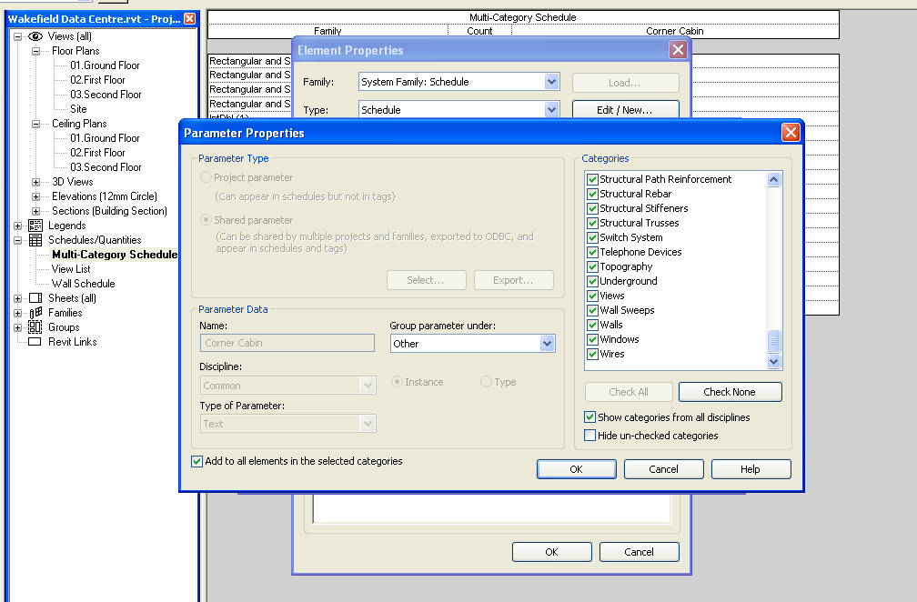

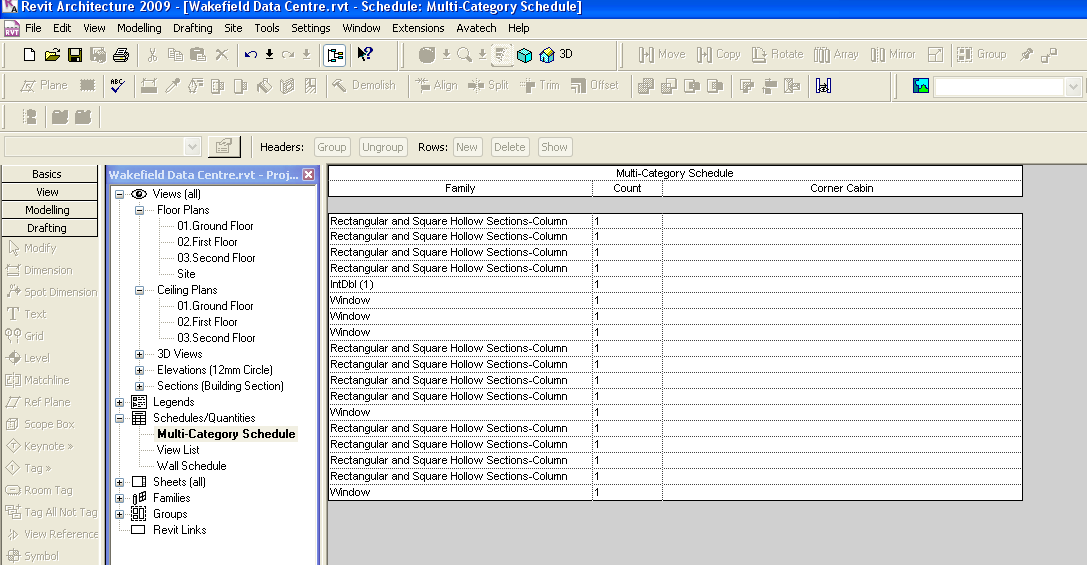

I am getting little success with multi-categories schedule but need some expert advice.
See attached snapshop for schedule. Schedule now showing all columns, doors & windows. The items missing from schedule are walls, floor & ceilings.
See attached snapshot 2 for my shared parameter properties and please advice me something.
 Thanks in advance
