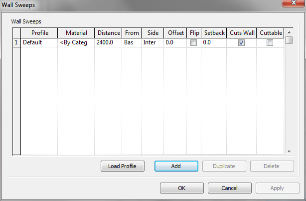

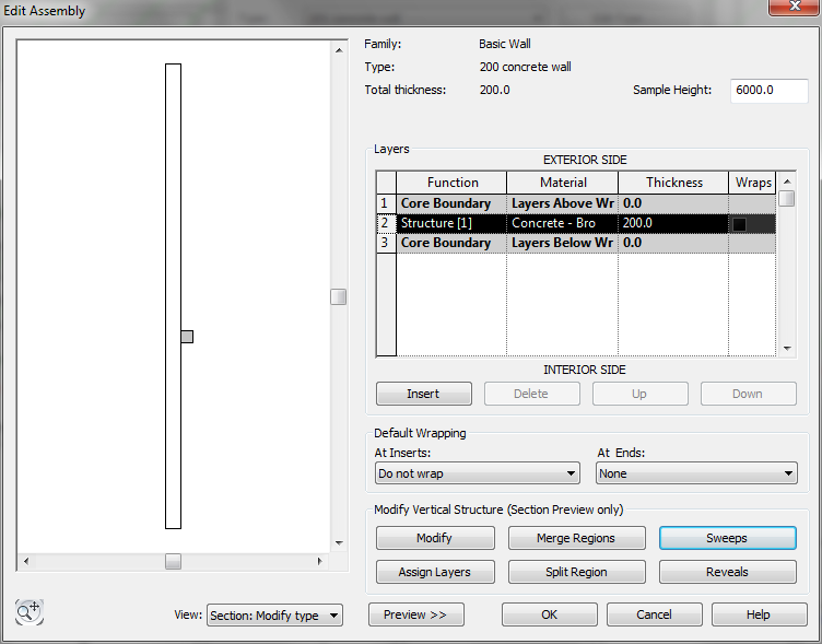

are you talking about cornices??
the simplest way is to create a sweep profile on your wall type, just edit the type and click the sweep button in the wall properties.
load the profile you want and specify how high it is from the floor (among other things)
see attached screens.
