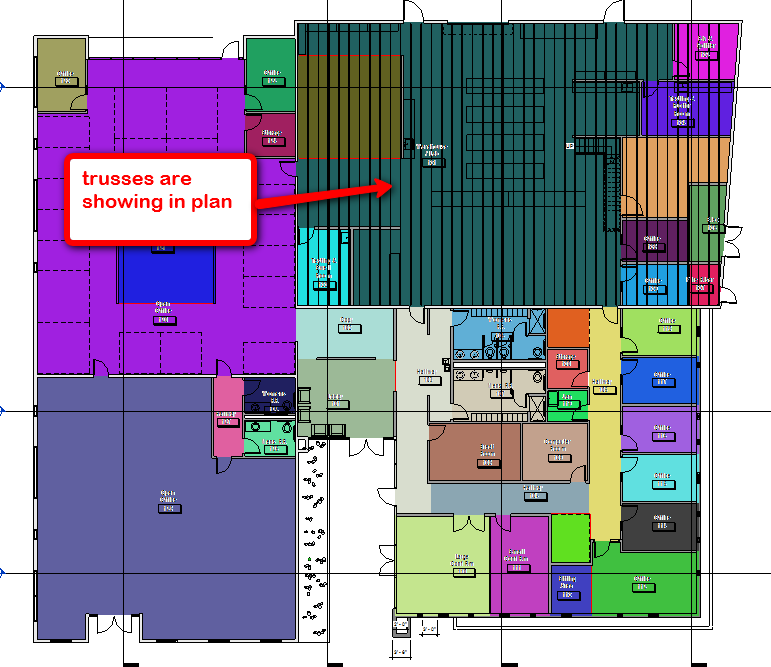

I am suddenly having a weird issue where my trusses show in one area of my building in plan view. The weird part is they are higher in elevation than the rest of the building. I have verified it is not the view range and other than that I am totally stumped.....

so i problem solved this one on my own but it still makes no sense. Over my warehouse I hosted my trusses to the bottom of my plywood roof, when I did this the trusses show in plan. When I detached them from the plane, copied them, and deleted the originals..... voila, no more trusses in plan. I guess since I usually attach my roof to my trusses rather than trusses to roof I had never come across this issue.
