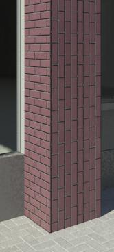

I am having a rendering problem where the material (in this case brick) rotates 90 degrees on different faces of an object. The brick is supposed to be horizontal all the way around the column, but rotates on the front face. The object is a solid form in a wall hosted family. Any help is appreciated.

Rotate the fill pattern.  Select one of the pattern lines (you might need to use the tab key to select it) and rotate it.  Dependinf on how it was created, you might need to go into the family to rotate it.

I actually didn't even have the fill pattern turned on for the material. All I had to do was turn it on and problem solved! Thanks!
