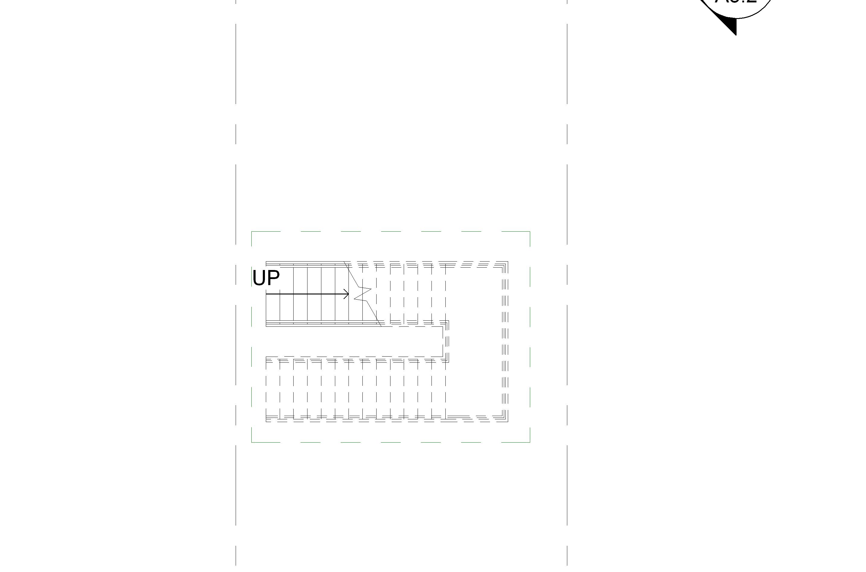

Here's the Jpg
Tue, Mar 17, 2009 at 10:26:49 AM | Stair Display Problem for WWHub
3.5 Stars: 395 Votes
Here is my test file showing two stairs - one with a plan region.
Tue, Mar 17, 2009 at 11:22:57 AM | Stair Display Problem for WWHub
Folks - just to update you as to what this problem was-
Plan regions did not seem to be working.
The problem was caused because the user was in Project North mode.. when he changed back to true north - plan regions worked.
Souds like a possible bug.

My attempt with your numbers
Tue, Mar 17, 2009 at 11:31:55 AM | Stair Display Problem for WWHub
JFK64
Joined: Tue, May 8, 2007
45 Posts
Let me clear it up just a bit.
Originally I was in True North Mode when I drew the Plan Region. That's when it didn't behave correctly. I then erased that Plan Region, changed to Project North drew in the Plan Region. Then I went back to True North (where the Plan Region looks cock-eyed) and the Plan Region behaved correctly.
Long Process but it's works.
