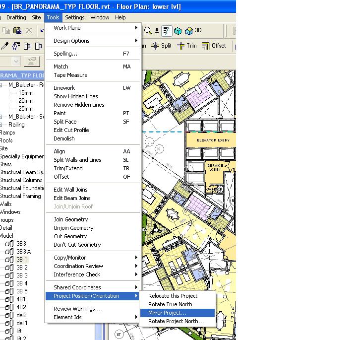

If you are using Revit 2009, you have a tool to mirror the project.
I have attached an image, just see it.

Thats brilliant. I have always gone down to alter the Project/True North and never noticed mirror project tab next to it. Thanks to all.
