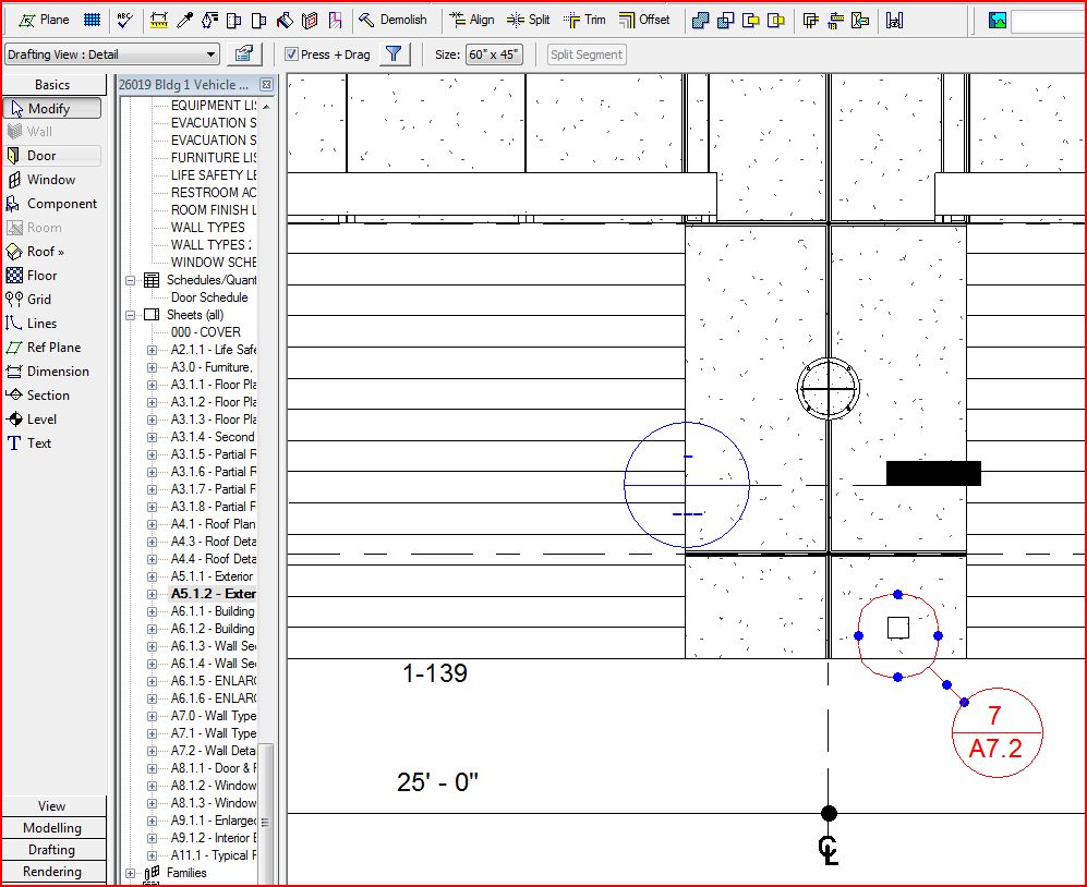

In revit 2009 is there a way to change the size of the bubble for the detail view under Section?  i can change the sizes on all the others but not this one.  even under Callouts there is another detail view option but it gives you the box rather than flat tail on the end and you can change this one but it doesnt affect the other.  any help would be great

i have tried but it only changes the look of the detail view that has the box on the end and not the flat tail.  it works for eveything else except this one condition

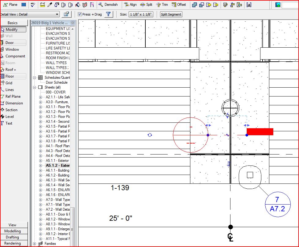

Can you upload a screen shot of the problem, I'm not sure what you mean.

you can see that both of them are Detail View : Detail.  the flat tail is created under section and the box is created under drafting view.  if you change the the calout under View Tags/Callout tags, it only changes the box one that was created under View/callout
