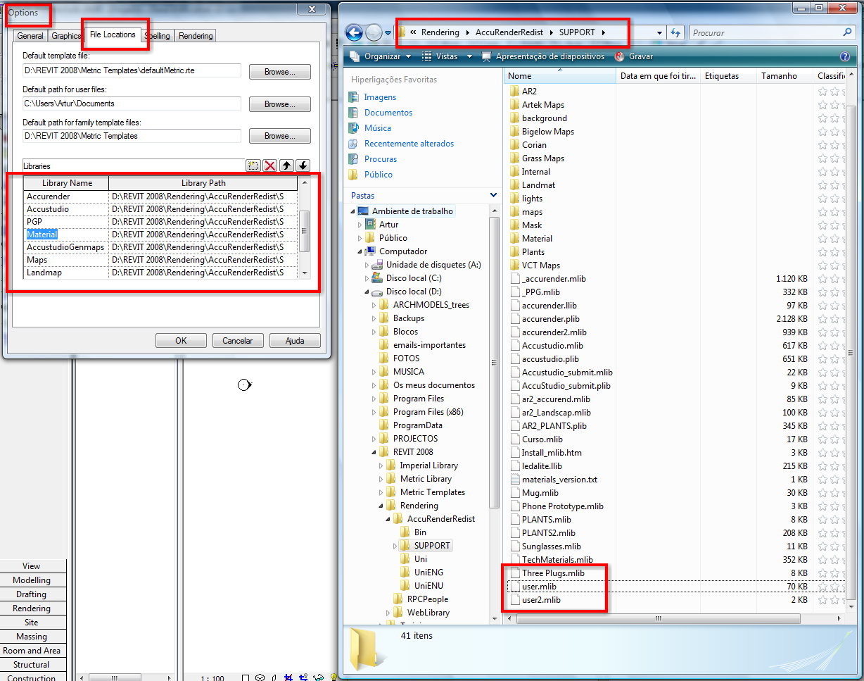

I have been working on a 2008 model on my workstation and only recently moved to a faster workstation for rendering purposes. All of the objects that contain custom materials are missing from my model when i go to render.  All of the families associated with the model have been saved to a shared location on the server.  Please see attached.
I know it has something to do with files on the pervious computer, but i can not contect one and two.  If anyone can help me out i would be most appreciative.

Hi, in 2008 you can save your materials in "USER.mlib" library, so i suppose you create (duplicate) some of those materials and give it a name and save them in a "USER.mlib", you must check where (in the first workstation) Revit saved the "User.mlib", by default (and if i remember) it's "c:\documents and settings\all users\application data\Autodesk Revit 2008\Accurenderedist\support\.... so here you have all .mlibs from RAC 2008, copy the "user.mlib" (or all of them) to your new Workstation and check in settings-options where is the path...

Thanks Typhoon.  I realy didn't expect such a comprehensvie response.  Much appreciated.
