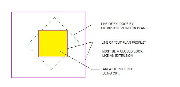

Since 2 days now I'm working on a hard shape and I'm not doing well. I started to do it with the roof by extrusion but didn't work because with the option "cut the profil" don't work....any idea?

The "Cut Plan Profile" tool works by defining the are to be Cut. The area to be cut needs to be a closed loop. Much like your standard sketch mode for floors or roofs. CryingSee Attached Image)
