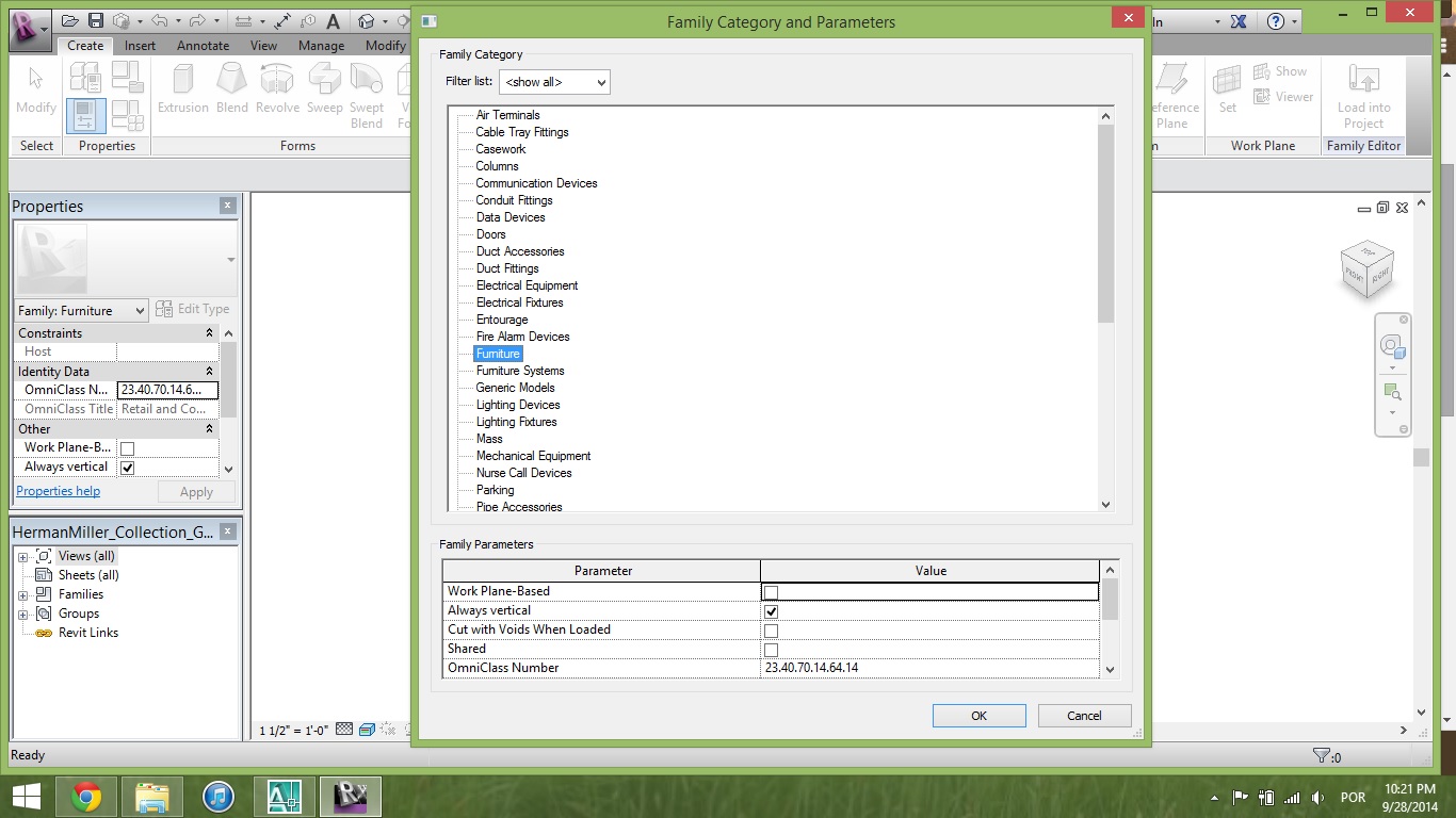

When I open Family Category and Parameters, there are no dimensions especified nor a parameter that i can change.

You are not supposed to change any dimensions of parameters under "Family Category and Parameters". Just change the family category to "Specialty Equipment". This will make Revit recognize the object as such.
Changing parameters and dimensions is always under "Family types" and "properties".
