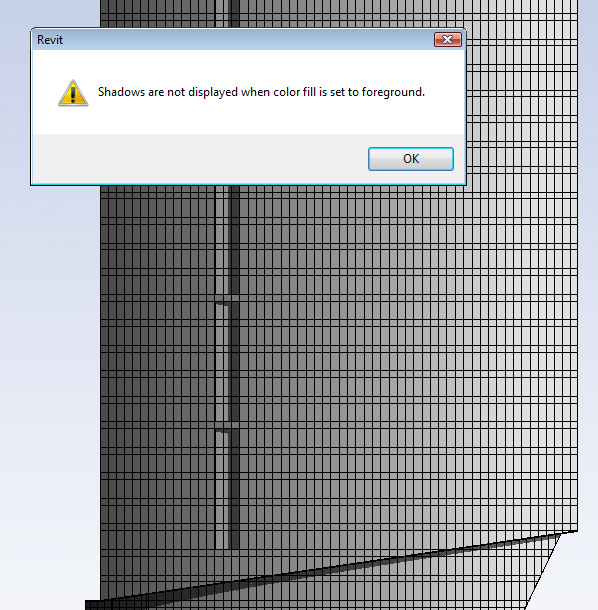

When I am working in an elevation view and have shadows turned on, if I create a filled region, the following error message pops up: Shadows will not display if color fill is set to foreground.
Sounds simple enough, yet I cannot find the option to set the color fill to the background or foreground. Obviously this does not mean "draw order", so can anyone tell me where this alleged "background or foreground" option is for a filled region. As of now I have resorted to using a masked region, though white is my only option.

I have uploaded a screed shot of the error message. Sorry, I am using a filled region, not a color fill. Which is why this error message is so confusing. This message appears when I am in an elevation view, have shadows turned on, and then click the filled region tool. Thanks for the reply.

I could not reproduce this message.  I created a filled region then turned on shadows - no problems. I edited the region with shadows on - no problem.  I added a filled region with shadows on - no problem.
I must say - I don't know why you would ever do this anyway.  First - filled regions will not shadow and second - I always turn off shadows anyway when I work in a view because it's way too slow.

I have to agree with wwhub on this. I can not reproduce the error msg. The only time I have ever seen this is with color fills in a plan view...never with filled regions.
I even tried setting a color fill to foreground then went into an elevation and tried the filled region and still nothing.
This should not be happening with a filled region and if it is, I would send this issue to your reseller or create a case with the factory if you are subscription.

Has anyone solved this problem...
the problem accurse when you place a transparant filled region in a elevation.
We got the same problem and i can't get the shadows to work anymore in this view...

i know this was kinda a long time ago and dont know if it was resolved but i just had the same problem and to fix it,
turn all filled regions to solid. transparent filled regions cause it.
my houses wouldnt shaddow due to the drive way and adjoining properties being a transparent fill.
