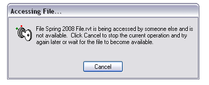

FYI, you cannot have the file open when using Show History

I just did it with the file open and it worked.  in revit 2008 sp3

Quoting lunchtrayrider from 2008-03-20 15:55:50
"I just did it with the file open and it worked.  in revit 2008 sp3"
are you sure, dosen't with Revit 2008 sp2, not the currently open file. backups work but not currently open file.

I guess what I did was I selected the local file after file>show history.  I didn't get any error with that.
