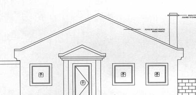

How do you draw parapet wall. I've attached drawing that I was trying to draw but couldn't really figure out where to start. Somebody please help..

For basic parapet wall (same materials throughout), sleect wall, edit profile and go to elevation of wall and draw what you want to see in elevation. Ensure wall height is set to non constrained and you do not extend to a roof. From this you can make any eaves shape you require at gable ends. However, you may get odd junctions at corners, just depends on what wall height you are connecting to. Once you have the elevation you want, create an in place family for the coping and select path as being along top of wall, then draw coping in side elevation/section view.

I never thought that i would get a reply this faaast. Thanks a lot fazerneil. That wanst too hard nor tricky.... yet i couldnt think of it......i think i need more practice. Thanks.
