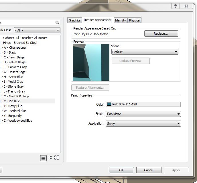

Ok one last update (I hope)...I realized that this was too good to be true.  The manufacturer has 16 finishes for each family.  So when you open via the project, it does not load the materials that are not being used.  So I transfed the missing 15 materials into my family and it increased the file size from 412KB to 612KB Sad
Does anyone know why materirals are so large!?
