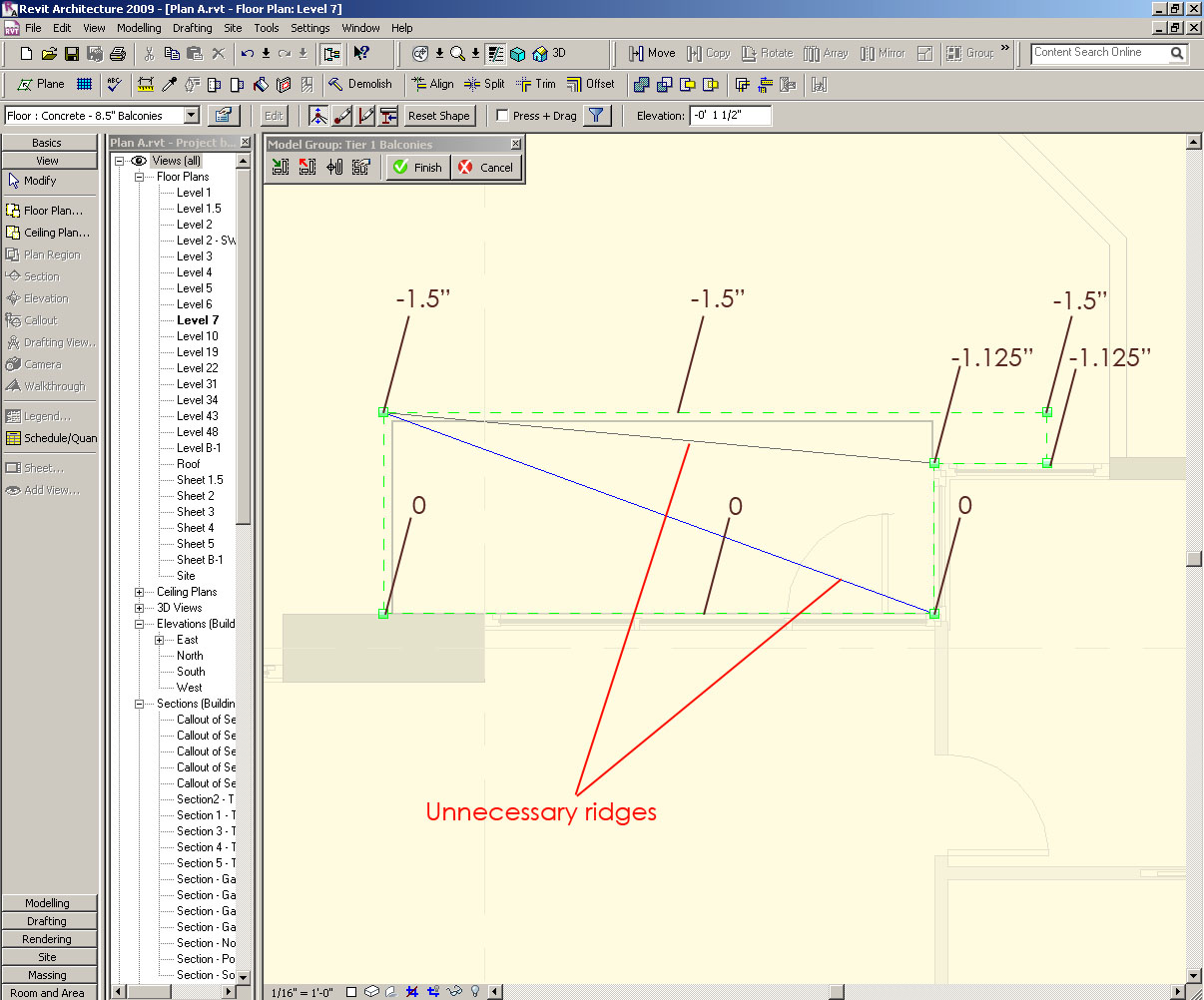

I've got a balcony that's got more than 4 edges, but want it to have a simple slope (no ridges or valleys) from the horizontal window edge (bottom of screen) down to the single long edge (top of screen). I figured out approximately where the short horizontal edge (screen right) should lie on the slope, but the ridge lines wont go away. Any way to accomplish this?

Revit is very exact. if you do not have the short horizontal figured out it will connect with the ridge lines.  Have you tired using a slope arrow when you edit the balcony.  That way you don't have to guess and the elevation  of the one point.  I would take them all back to zero and try the slope arrow method.

the problem with the slope arrow (if I'm not mistaken) is that it will slope both the top and bottom of the slab. The bottom needs to be flat while the top of the slab tapers down (for drainage)
 Rendering is not the issue. These will be construction drawings so the end product is a hidden line plan view where the unnecessary ridges will be visible as they are now.

The linework tool is for tweaking visible lines to make a drawing more clear, not for covering up dirty little errors in the model. Making the lines invisible is a quick fix but come on, there has to be a way to do this right?

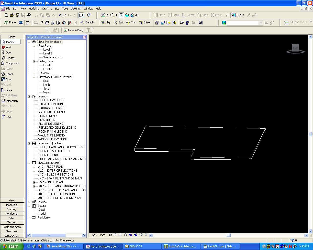

Create the balcony.  duplicte it in the same place then use the slope arrow on one. join geometry and you get what i have in the jpeg.  Hope that is what you are trying to do.

Nice work around wheelergc that's exactly the geometry I'm looking for but I feel like that might be more of a pain than it's worth (there are a lot of balconies) - especially as the design may change.
Typhoon - There's a fundamental difference between warped surfaces (like topography) and flat surfaces (like balconies). It's not that big of a deal but having ridges on a flat sloping balcony is absolutely a modeling error (in that it really shouldn't be that way). Using linework to hide the ridges is A) a "duct tape fix" and B) forces you to make sure every view where a balcony might show up is adjusted with linework. You can't argue that it wouldn't be better if the geometry were simply modeled correctly.

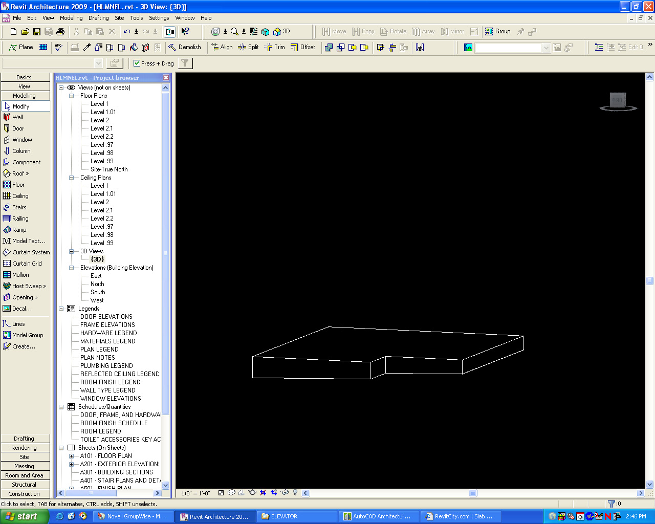

ok went and gave it another shot. If you select the lines instead of the points and move the whole lines elevation you can get it to work.  But you have to be exactly right.  This one was done with -6" on the far end and -3" on the short line.  but the is really easy to figure out with the shape i drew.  If you know the exact spot that line has to be in you can get this to look right. Hope that helps.

sorry wrong one this is the second try.

I think that's the method I'm going to have to go with - I was having trouble because the dimensions of the balconies are weird (like to the 256th of an inch and probably rounded to that) due to some sloppy work earlier when placing window-walls... I'm going back now to adjust the dimensions to round numbers - hopefully then the fractions will work out evenly so I can enter exact elevations for the different points. Thanks for your help and for testing that method!
