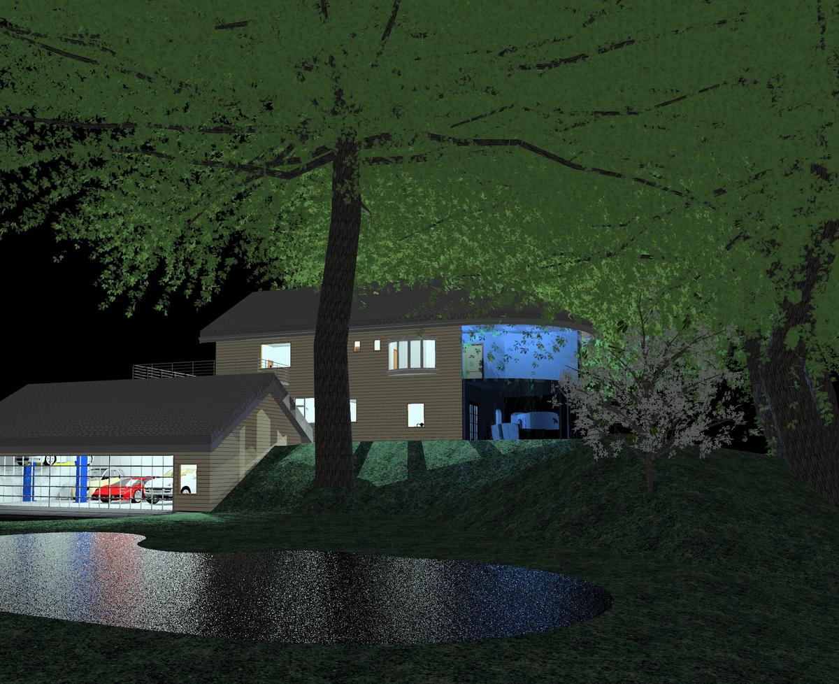

looks good.  I have had a problem with the siding not showing up crisp at all and I just figured it out.  Try going to settings,materials,Finishes Exterior Siding,pick the accurender texture,Exterior siding,pick material editor,select Joint,select base color HSB and adjust it from black to more of a gray click OK then save as, Name it and store it in the user folder for future projects.  good luck
