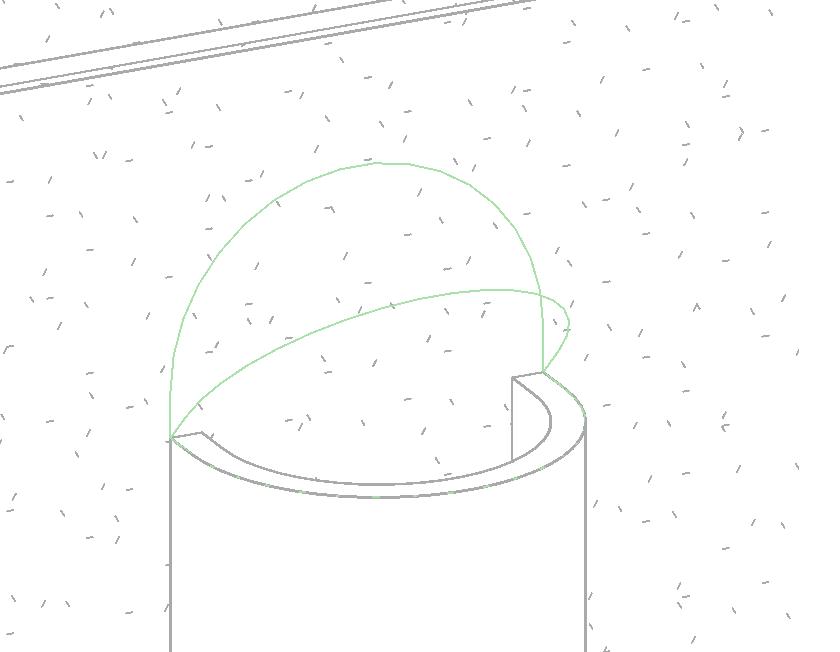

i'm trying to model a rounded roof by face but cannot create a reference plane at the middle model line to use for creating a mass. any suggestrions?

I would model an in place family by rotating a profile of the roof 180 degrees.

In-Place Family in Roof category, Revolve like Beau. said
