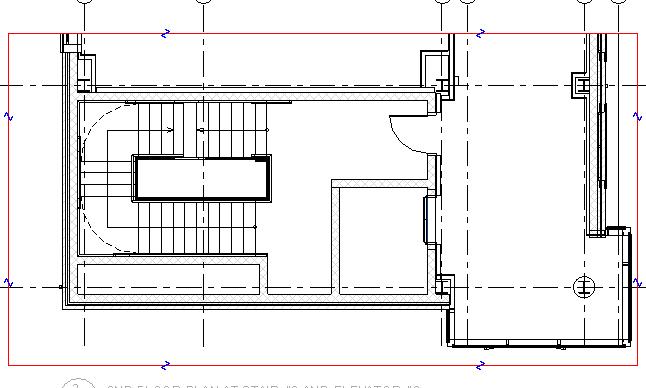

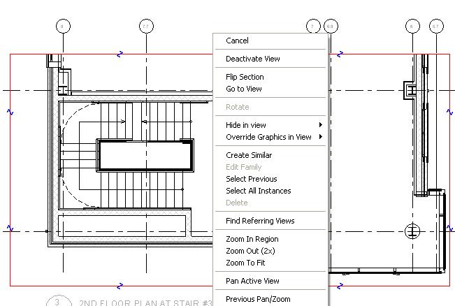

I have used a detail callout in the floor plan and did a lot of detailing in the callout, now I want to resize the callout, but couldn't, when I select the callout I can see the grip points on all 4 sides, but when I try to drag them they are again coming back to the same location. When I open the callout and select the crop region and right click it, I neither can see the delete button highlighted(See Attchment 2) nor the grip points(See Attchment 1).

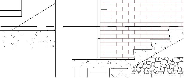

Another issue is in the same project some of my fill patterns(Concrete) are broken in one view(Section) where as they are fine in all other views with the same scale and I also tried apply template too. See Attchment 3 there are 2 diif views.

With regard to the callout, it may be that it's pinned.  You can't resize it if it is pinned, either in the view or on the callout bubble.
I'm not sure what you mean about the fill regions - they appear fine in the view that you posted.

No the callout is not pinned, if pinned you can't even see the grip points for the the same in the floor plan. Regarding the fill patterns in the left side view there are traingles in the Concrete pattern, but not in the right side view, looks like broken.

got answer...the callout is linked with the scope box...I kept none for the scope box then it worked.
