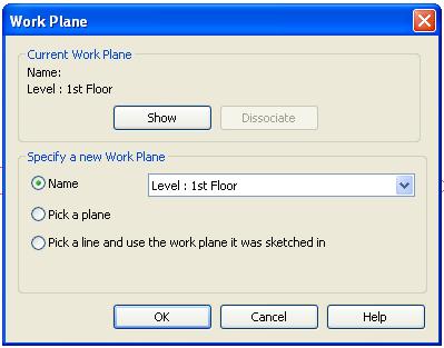

Hi.  I am just learning how to use Revit and am trying to create a building with semi-complex geometry.  I am using massing to create the form and have run into a little problem.
I would find it much easier to create the mass if I was not restricted to working within a workplane, after some google searching I found all I need to do is dissassociate the mass from workplanes... however when I open the "Edit workplane" window, the "dissassociate" button is greyed out and will not let me dissassociate anything.
 The attached image shows the edit workplane window I see.
 Does anyone know how to make it possible for me to dissassociate from workplanes?

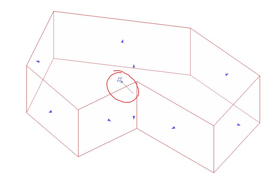

Click on the mass, then click on the EDIT button on the toolbar.  Then click on the mass again.  You should see a symbol like the one shown in the attached picture.  Click it.  This will (should) disassociate the hatch.  HTH
