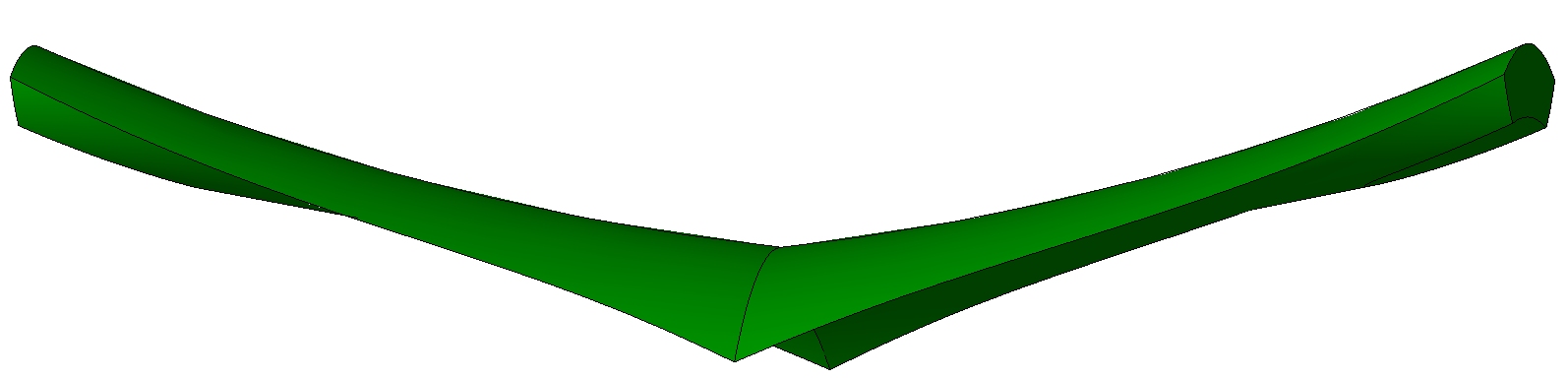

I had a fourth try with Modelling > Create First I made a Extrude to have something to Pick a Plane from That Extrude I will delete before I finish the family But before deleting it I used it ffor doing a Solid Blend - as before - doing one half of a tensile structure. And then Void Sweep with a curved path and a curved profile to give the upper side of of the Solid Blends with its straight extrusion Path a curved upper surface in both directions Then I used Void Sweep to do the same thing - cut a bit away - from the Solid Blends underside. OK! That was not so easy trying to make just that form I wanted So you have to give it a little more time of experimenting.... I had also to use Void Extrude to cut away the worst pieces of my experimenting.

And here is the result after finishing the family and then doing a mirror copy

Here is two views trying to show the curved upperside The underside is not so nice needs a little more experimenting but it is also curved And the other view more from the top shows the resulting curved outer sides of the Solid Blend

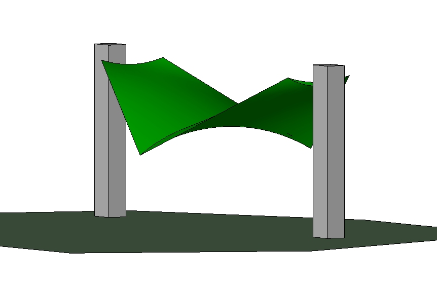

Doing it in 3D Studio is the right way!!! Here an image in the upper part showing how to do it in 3D Studio and then exporting it as .dwg and then File > Import in Revit and just Render which is showed by the two pictures below. Taking a look on what you can do in 3DS - there are several ways in 3DS but this is one possible way. I choosed Create then Nurbs Surfaces and then CV Surface and made in the Top View. Next step: I choosed Modify and selected the surface and Surface CV and one point . I selected two opposite points on the countour and in the Left view moved them upwards The two new point and moved them downwards. That is all then export to .dwg. Then importing in Revit choose Manually place so you can get the tensile structure on the right height..

ACAD I hate!!! It is stupid as far as I know. And I know it for its 2D "support"... OK! I know a little bit 3D in ACAD too - but I think there is other members knowing so much better. And as far as I know there are no NURBS in ACAD and for sure there will never be because Autodesk want to have them only in 3DS.... A little programming and you could have NURBS in REVIT too, but there is someone saying NO NURBS.... That is what I think NURBS are good for doing smooth things easy. So NURBS is the nice thing then doing tensile membrane structures So my advice - do it in 3DStudio All you have to do in 3DS to make the tensile structure is only two simple things - 2 things!!!! as the image shows you First with CREATE make a CV SURFACE Second with MODIFY move opposite vertexes up and down THAT IS ALL!!! And everything of it is shown to you on the image. OK! It is not video it is an image so you have to do a little experimenting in 3DS to get it right. But you will for sure make it... Then export to a .dwg-file and import it into REVIT Perhaps someone knows a good way to do it in ACAD but I do not want to try it in that awful program....
