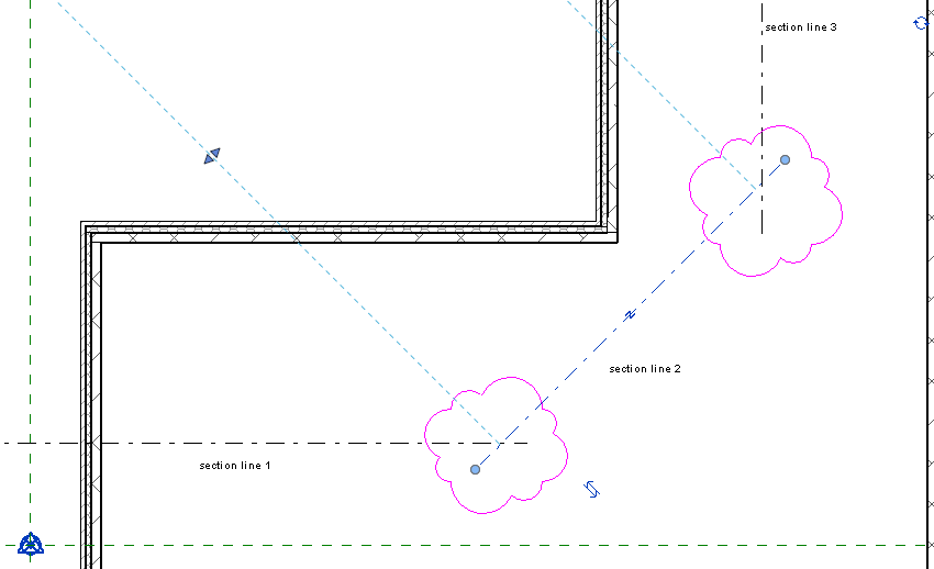

For a large project were drawing a terrainsection which is segmented. The section lines have different angles, it's not a split section.
Is there a way to trim/align the section ends at their intersection? Same for the view box? Or will we have to do this manually? We feel like if we do it manually, it's not precise enough.
Also is there a way to have this done in every view, similar to "propagate extents" for grids and levels?
See attached images (not actual project, just an example).

Where's the resulting view point from ? Section 2 ? or do you want a 3D section ? or do you want an 'unfolded view' ? Just curious.

The result we want is what you call an "unfolded view". So the three view from the sections next to eachother.
