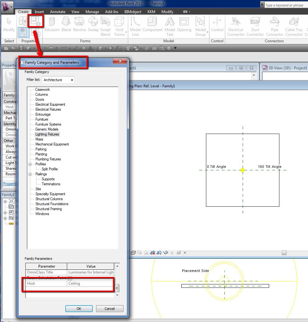

What is ceiling dependent lighting and how do I find it? I am having a hard time dropping lights in my reflected ceiling plan. Why wouldn't troffer lights be ceiling dependent. I have check my visibility graphics. Just shows as a black box and my cursor turns to a circle with a line through it? New to drafting, new to revit, going grayer faster than I need to.

"...and my cursor turns to a circle with a line through it?" - Because that light is not "Ceiling Based" family...

I check the family template and this is a ceiling dependent light? Where else should I look/check? I have the constraints set at my ceiling height. I can't get any fixture to drop in to the ceiling other than the lights in the soffit. thanks for your thoughts.

Open that family, goto "Family category and parameter" and check if that light is ceiling based, Host must be "Ceiling"

Yes. Did that. Yes ceiling is host. I am at a loss.

When you are about to place a ceiling light, check the placement options on the placement ribbon and choose "place on face." for some reason known only to Autodesk, the defaut placement option is Place on Vertical Face, as if most things in a building are mounted on a wall. (See attached image.) This might fix the problem for you.
By the way, you want to use generic face-based lighting fixture families, not ceiling hosted. The reason for this is that ceiling hosted families can't be hosted to the ceiling of a linked model, so if you are working with a linked model, that could also be part of the problem.
