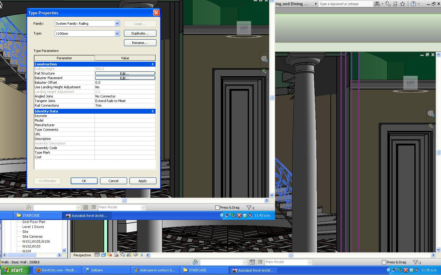

Sorry, still having difficulty. When I select the baluster in the project, I'm struggling 'to locate the baluster family from the project browser under families'.Where do I find the 'families' tool...?
See attached image for the menu I get up when I click 'Edit Type'

Wed, Jan 19, 2011 at 4:52:18 PM | I"M HAVING DIFFICULTY CHANGING THE RENDER COLOUR OF MY BALUSTER/STAIRCASE
#15
CRB14
Joined: Fri, Oct 22, 2010
86 Posts
Awesome! Sorry it took me a second till I saw the attachment you sent. Much much appreciated! See render for outcome....still annoyed I couldn't figure it out though! Champion, thank you
