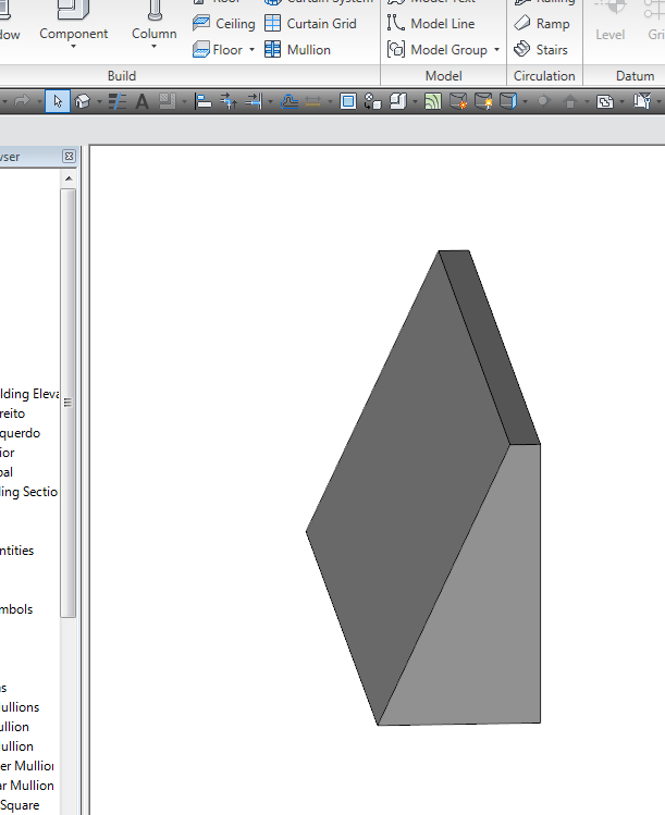

how i can create wall wtih having different width at bottom and top
Sat, Jan 23, 2010 at 6:42:07 AM | slope wall
Joined: Tue, May 22, 2007
5921 Posts
4 Stars: 201 Votes

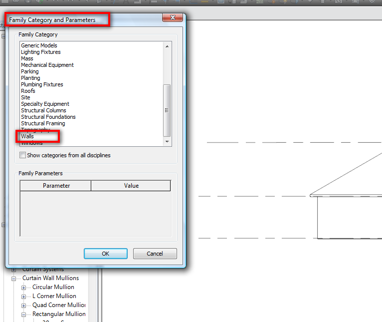

You can use the "Create In-Place" in the category "Wall" then use the "Solid Extrusion Or Solid Blend or Solid Sweep" to do that...

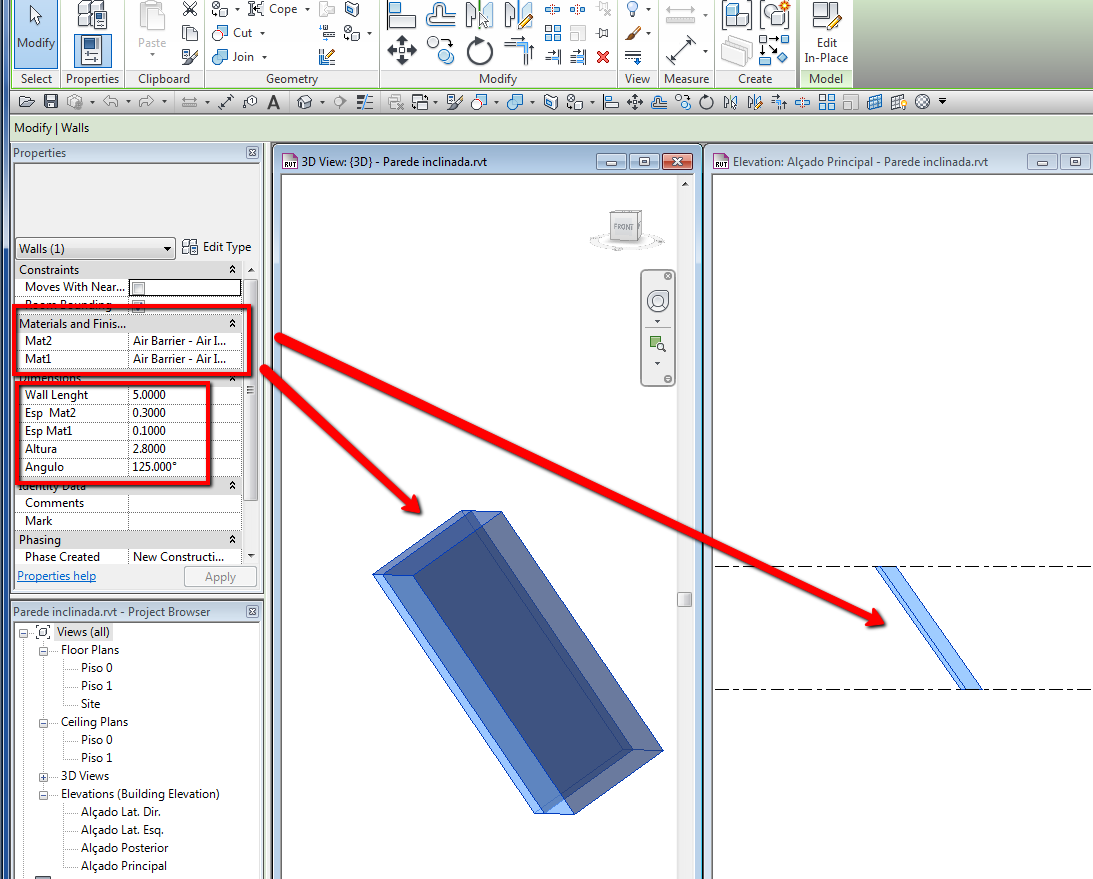

yeah this is great. but how you gonna manage the material layers
Tue, Jul 5, 2011 at 6:16:00 AM | slope wall
5921 Posts
4 Stars: 201 Votes
Simple, create SEVERAL parts (layers) like you want/need with different materials, watch image attached (just an example)
