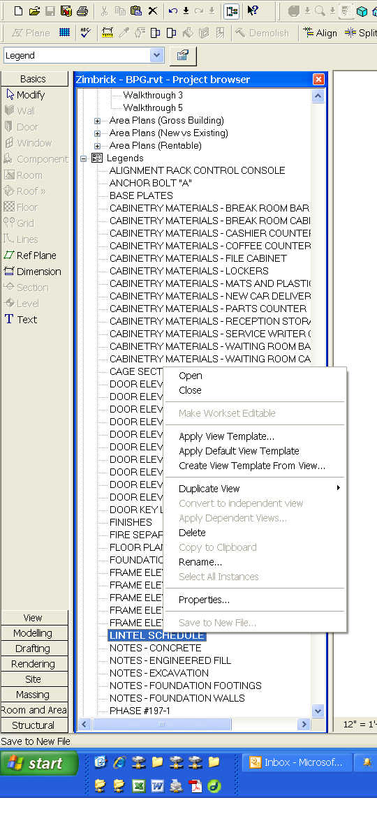

Is there a way to copy a legend from one project to another?  I've been able to copy just about everything else, but not legends.

Thanks for the response.  I tried that on several legends in two projects; the "Copy to Clipboard" option is always greyed out. : (  I tried Transfer Project Standards also.

Frustrating that it's not working for me.  Do you mind taking a look at attached image showing that the copy to clipboard is grayed out?  Could there be something else keeping me from doing this?  A permission or something?  I'm able to right click copy other items.  I checked worksets to make sure I can edit all.  Thanks for hanging with me through this!

Ah... more detailed question - more detailed answer.
Keynote legends all copy/clip.  For other legends, open legend and copy/clip paste into new legend in new project.  Note that when you do that, you will be importing new model components if they do not exist by same name in the target project, otherwise, even if same name, the components will be the project components.

That explains it - Thank you!!
